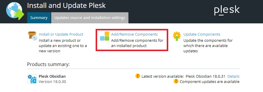

Using Plesk interface
Log into Plesk.
Go to Tools & Settings > Updates.
Remove the component
Roundcubeand then install it again.
