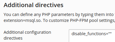

If there's no section called disable_functions, add disable_functions="" to Additional directives instead.
