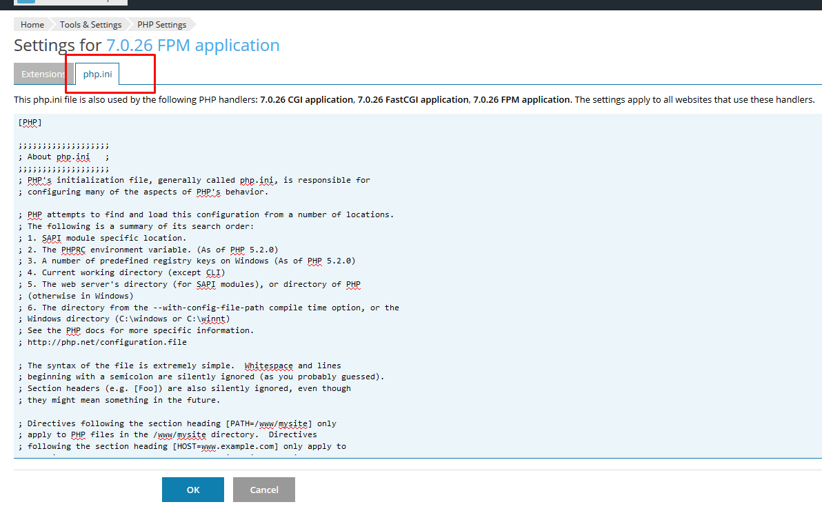

Edit php.ini for all domains
Global PHP handler configuration file is stored in Tools and Settings > PHP Settings > click on a PHP handler > php.ini tab:
Edit the required options and click OK
Note: Some of the options may be hidden by Plesk administrator. Upgrade to the latest Plesk version to be able to edit these options in Plesk interface.

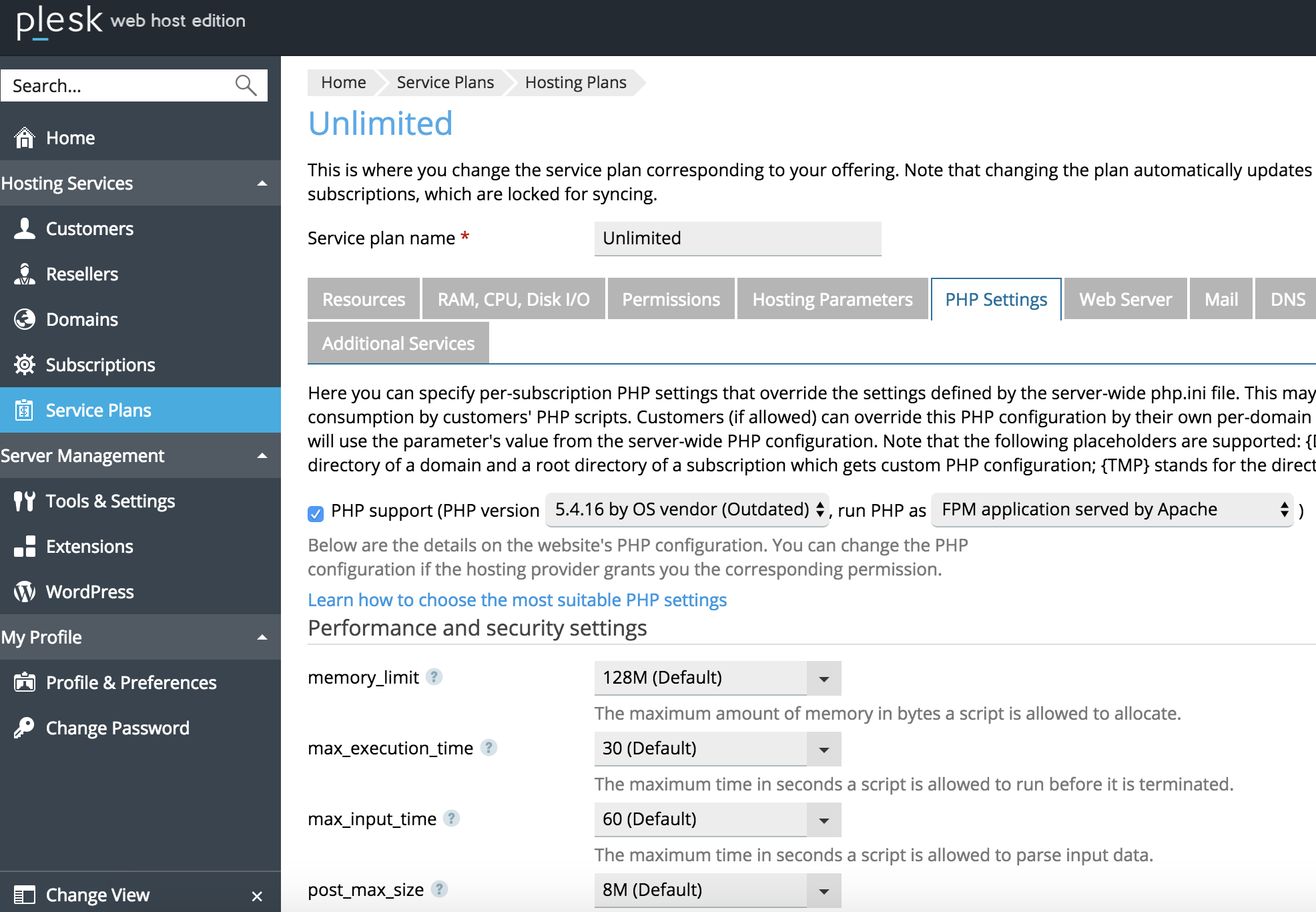

Editing PHP configuration via Service Plan for multiple domains
If it is required to make changes for few subscriptions, it is easy to do via Service Plan.
Assign all the required subscriptions in Service Plans
Go to PHP Settings and after changing them click Update & Sync.
