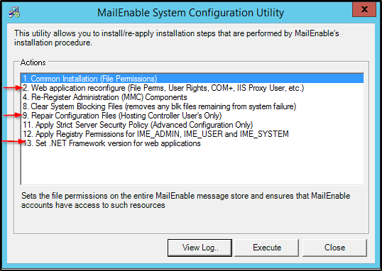

- Launch
C:Program Files (x86)Mail EnableBinMEInstaller.exe
utility. - Execute actions 2(Web application reconfigure), 9(Repair Configuration Files) and 13(Set .NET Framework version for web applications).
Note: MEInstaller.exe will ask for a password. Specify a password that satisfies the Windows complexity requirements, because this is an IIS user password (if not complex enough, it will not be accepted and the corresponding system users will not be created and updated).

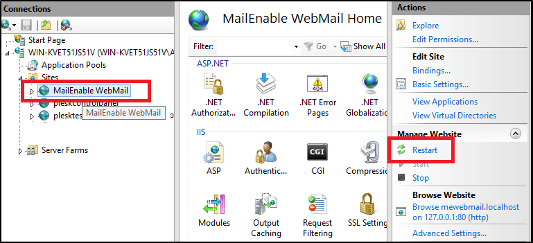

- Restart MailEnable WebMail site under IIS > Sites:
