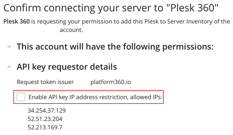

Disable restrictions
Remove the server from Plesk 360 > Servers
Add it again but disable the restrictions:
