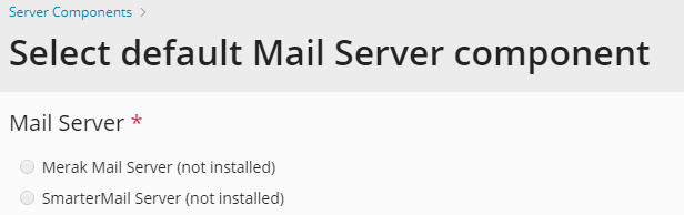

In Tools & Settings > Server Components > Mail Server the following can be seen:
SmarterMail Server (not installed)
