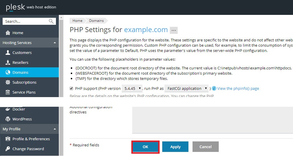

Log into Plesk and re-apply PHP settings in Plesk > Domains > example.com > PHP settings > Ok (without any changes):
