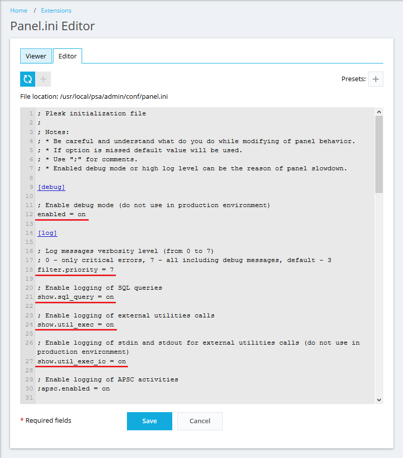

The debug mode can be enabled either via the Plesk Panel.ini Editor extension in Plesk or in the Plesk configuration file "panel.ini" directly on a Plesk server.
In Plesk for Linux, debug log entries are written to the Plesk logfile /var/log/plesk/panel.log. Also, when running Plesk utilities with debug mode enabled in a command-line interface, they will produce debug log entries in their output.
In Plesk for Windows Server, debug log entries are written to the Plesk logfile %plesk_dir%adminlogsphp_error.log.
Warning: Once you are done with troubleshooting, disable debug mode back. Otherwise, it may fill up disk space over time.
Install the Panel.ini Editor from the Extensions menu in Plesk.
Open Panel.ini Editor at Extensions > My Extensions.
In Panel.ini Editor, switch to the Editor tab. If the editor is empty, do the following:
3.1. Download the panel_ini.txt file.
3.2. Open the downloaded file and copy its content.
3.3. Paste the content into the editor.
Edit the the content and click Save:
To enable debug mode, remove a semicolon ";" at the beginning of the lines highlighted on the picture.
To disable debug mode, put a semicolon ";" back at the beginning of the lines.
