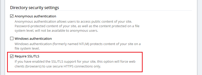

The Require SSL/TLS option is enabled for the domain in Plesk at Domains > example.com > Hosting & DNS > IIS Settings.
Because of the Require SSL/TLS option, a web-browser forces HTTPS secure connection, but the website is served over HTTP and the 403 forbidden error is returned.

To make the website accessible over HTTP, disable the Require SSL/TLS IIS option:
in Plesk
Go to Domains > example.com > Hosting & DNS > IIS Settings.
Disable Require SSL/TLS option under the section Directory Security Settings.
Apply the changes.
