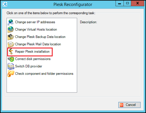

Open Plesk Reconfigurator from Windows Start menu > All Programs > Plesk.
Click the Repair Plesk installation button:

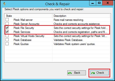

Mark Plesk File Security and Plesk Services checkboxes and click the Check button:

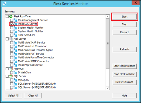

If it was not started automatically on the previous step, start the Plesk SQL Server service via Plesk Services Monitor under Windows Start menu > All Programs > Plesk:

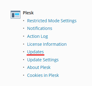

- Retry Plesk upgrade or update via Plesk > Tools & Settings > Updates
