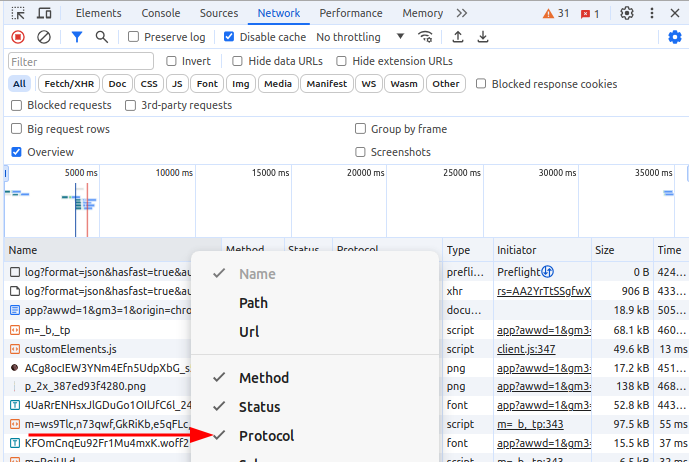

- Open Dev tools
- Select the "Network" tab, right click on "Name" and place a check mark on the "Protocol" entry:

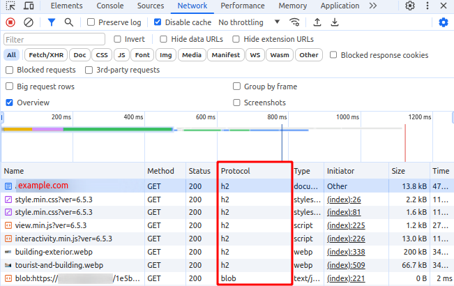

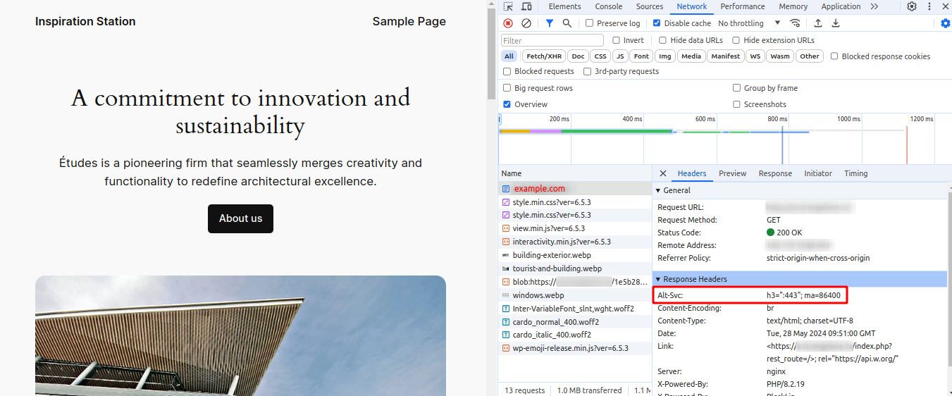

- Then without closing Dev Tools, open the website where http3 check should be performed and click on the first response:
The "Alt-Svc" header means that nginx is serving http3 and lets the browser know the page can be accessed via http3. Even though, the first query will always(until the headers are cached) be http/http2:

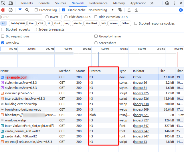

- Refresh the page and check the results:
Note: Meanwhile for the website with invalid(outdated or containing a different subject name) SSL certificate http3 will work on Firefox, it won't be working on Chrome

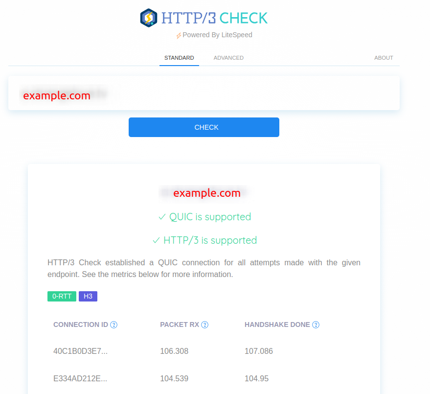

Navigate to the online checker URL and specify the domain in question.
In case http3 is working as expected, it looks like:
