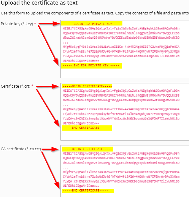

Open the certificate file (*.crt) with a text editor:
The file should be divided into two parts, each starting and ending as follows:
The first one concerning the Private key (*.key):
-----BEGIN RSA PRIVATE KEY-----
-----END RSA PRIVATE KEY-----The second one concerning the Certificate (*.crt or *.pem):
-----BEGIN CERTIFICATE-----
-----END CERTIFICATE-----
- Open the CA certificate file (*-ca.crt) with a text editor:
Note: The CA certificate file is generally included in the package when the certificate is purchased. If it's not, request it from its vendor.
There should be only one part, as follows

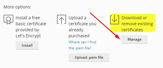

- Log into Plesk;
Go to Domains > example.com > SSL/TLS Certificates > scroll down to the More options section, then click on the Manage button under the Download or remove existing certificates:
Note: If there is a certificate installed already on that domain, in SSL/TLS Certificates menu use the Advanced Settings button.
Click Add SSL/TLS Certificate > Scroll down to the Upload the certificate as text section;
Paste each section from the certificate file into the corresponding fields, as follows:
Click Upload Certificate;

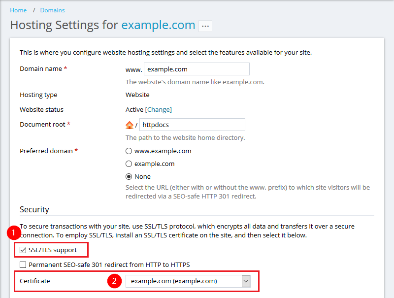

Go to Domains > example.com > Hosting Settings
Enable the SSL support option;
On the Certificate option, select the certificate uploaded on the previous step.
Click OK
