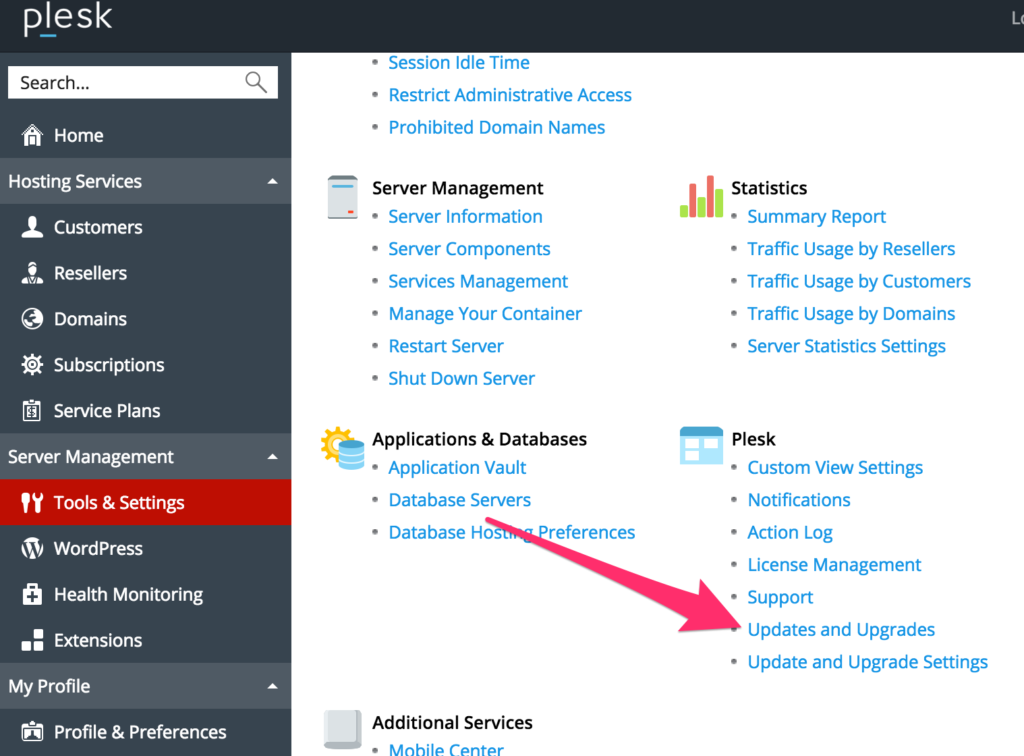

Ok, let’s go ahead. Log in to Plesk as the admin , go to “Tools & Settings” and click the “Updates & Upgrades” link:

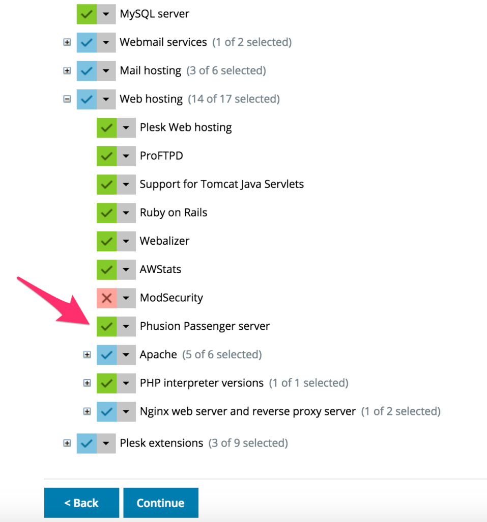

Click “Add/Remove Components” on the next screen. Expand the “Web hosting” section and mark the “Phusion Passenger server” component for installation:

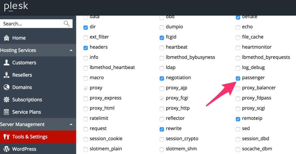

Phusion Passenger will run as a web server module, so after the installation, it will have to be enabled. Return to “Tools & Settings” and click the “Apache Web Server” link (found under “General Settings”). Here we need to enable the “passenger” module:

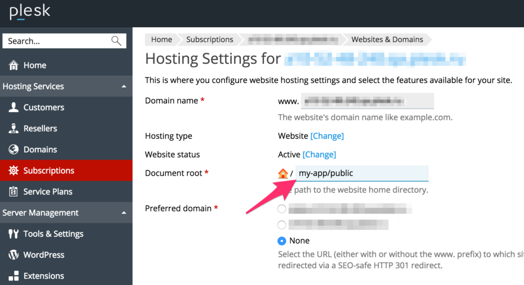

The next step is to prepare a domain for hosting our Node.js app. We need to set up a proper document root for the domain. By default, Phusion Passenger looks for the app.js file that should be located in the parent directory of the document root. We will deploy our app to the “my-app” directory, so we need to set up the document root as “my-app/public”. Go to “Websites & Domains” for your domain and click “Hosting Settings”. Here, we need to change the document root, so it looks like this:

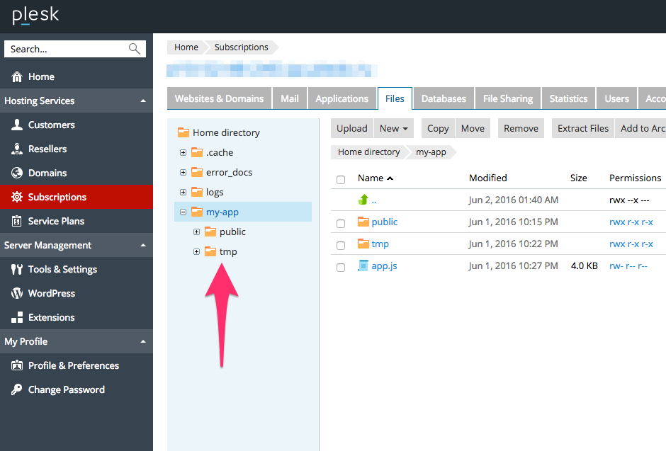

The final step is to deploy our Node.js app. We will use a basic “Hello World” app as for this example. You can use the File Manager to create the following directory structure in the root of the webspace:
Alternatively, log in via SSH with the webspace system user credentials (don’t forget to enable SSH access on the “Web Hosting Access” screen) and run the following commands
mkdir my-app
mkdir my-app/public
mkdir my-app/tmp
Then, create the my-app/app.js file with the following contents:

  12. You will need to uncheck “Smart static files processing” in “Apache & nginx Settings” in order to run node.js at the domain root
