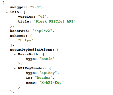

Now, API is described using Swagger format in JSON and YAML form. You can access the description by browsing the following URLs:
- https://<plesk-host>:8443/api/v2/swagger.json
- https://<plesk-host>:8443/api/v2/swagger.yml
To open these URLs, you can use a browser, and to see the JSON structure in a pretty format, you can choose to use a browser plugin (like JSONView for Google Chrome, for example).
Swagger scheme is also published at Swagger Hub. Since Plesk is not a SaaS service with static domain name, you can’t use Swagger Hub as a playground to execute API requests on your own server. But later in the “Tools” section, you’ll see other ways you can easily play with API. More info about REST API concepts in this Plesk doc.

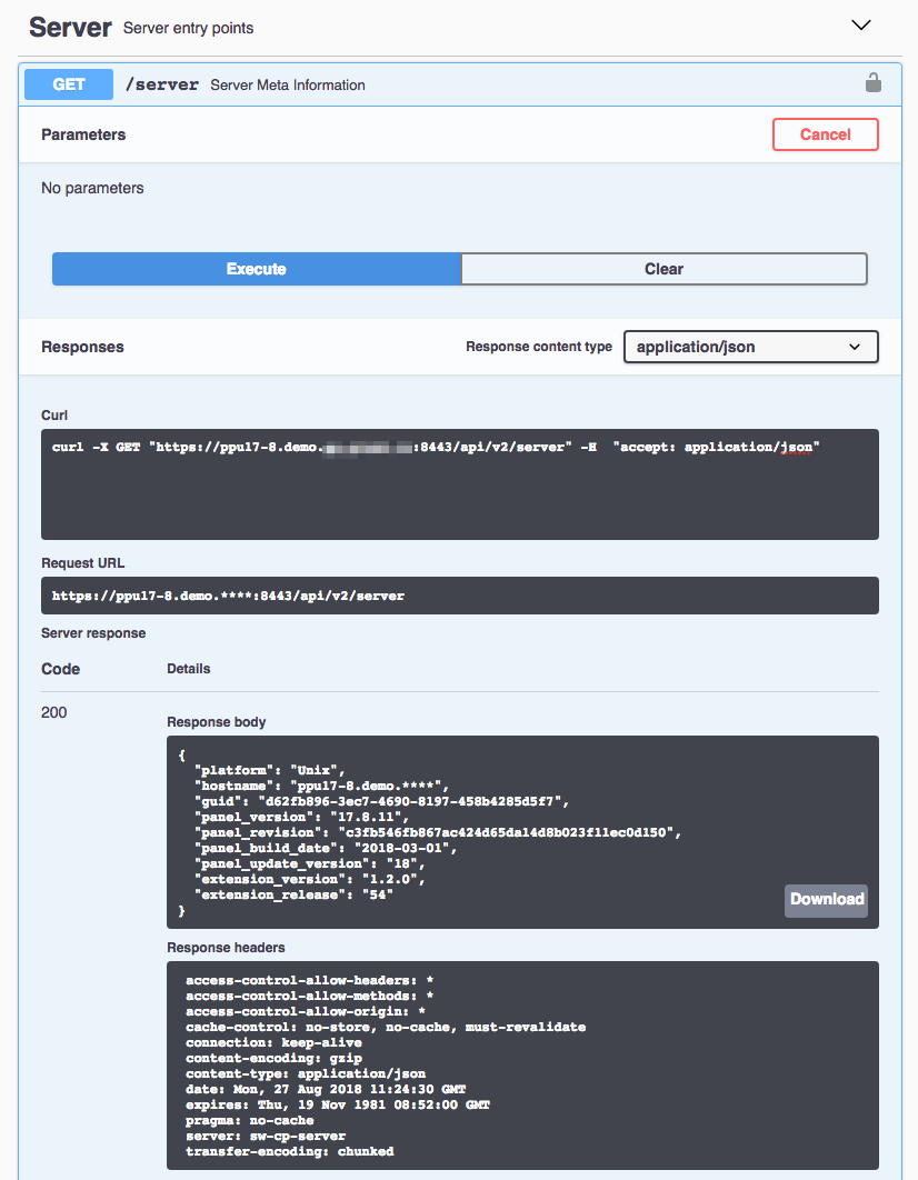

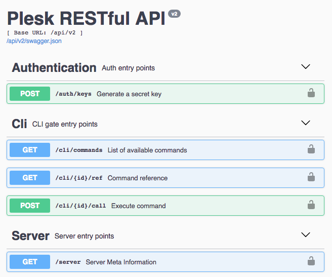

Integrated Reference & Playground
Plesk REST API comes with the integrated reference and playground. You can access it by browsing the following URL: https://<plesk-host>:8443/api/v2/ where <plesk-host> is a hostname of your Plesk server. The first time you need to enter your Plesk admin credentials. The reference looks like this:
It’s not only the reference, but also an interactive playground.
You can select the method, expand the block to see details and click “Try it out” in the right corner of the block. If there are additional parameters, it’s possible to provide a payload – the “body” of request. You can also customize API request parameters. After, you need to press the big blue button, “Execute” in order to see the results. Here’s how it works for the “/server” end-point (fetching meta information about the server):
The “Response body” field contains the real result of the API call. The integrated reference and playground is the best way to become familiar with REST API in a short period of time.

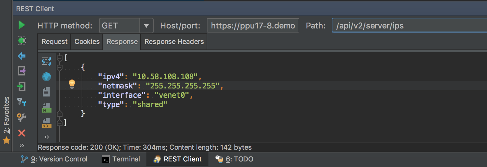

PhpStorm REST Client
IDEs usually have plugins or integrated REST clients. As an example, we can take a look at PhpStorm – which is probably the most popular IDE for PHP developers. It comes with the integrated REST client (see Tools -> Test RESTful Web Service option).
You need to specify host/port pair and the path. In the example below, I tried to fetch the information about server’s IP addresses.
Don’t forget to provide credentials. There is a small icon with the keys in a left sidebar, which allows to do it.

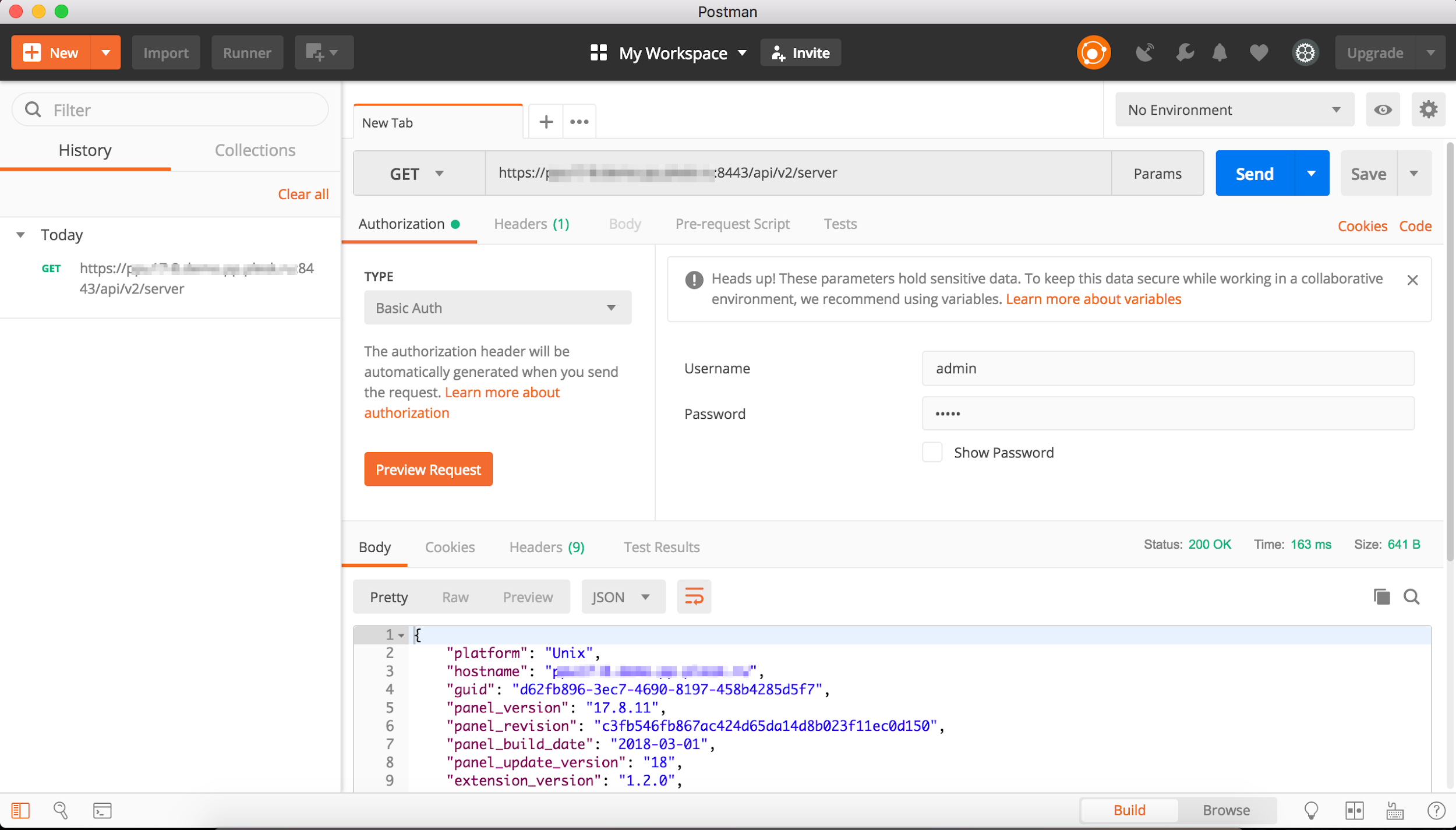

Making an API call to Plesk using Postman
Another very popular option is Postman. If you have no valid SSL certificate for control panel, you can disable SSL validation in Settings dialog (Preferences -> General tab). You need to type the full URL to end-point (we will check server meta information once again), provide the credentials using “Basic Auth” method and press the big blue button “Send” to submit the request.
If the execution is successful, the result will be demonstrated at the bottom of the screen. Then printed nicely with a syntax highlighting.
