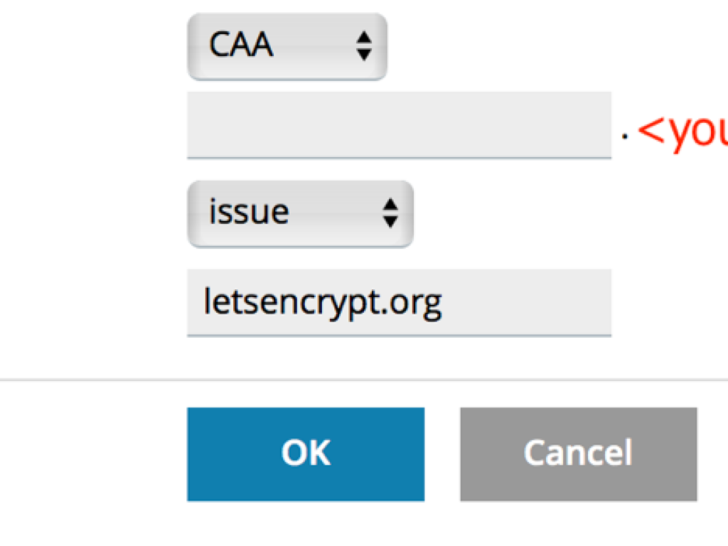

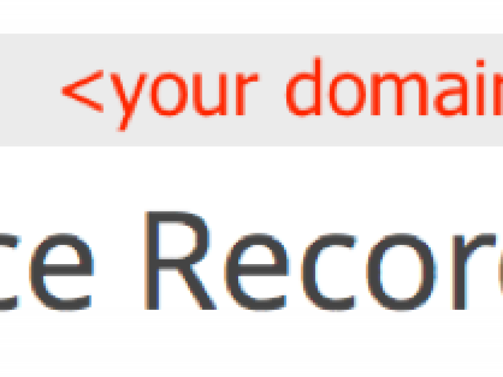

How to make Let’s Encrypt your main CA
You can set Let’s Encrypt as the only CA allowed to issue SSL/TLS certificates for your domain in Plesk. The Let’s Encrypt community post has also got this one covered. Have a look at the process below:
