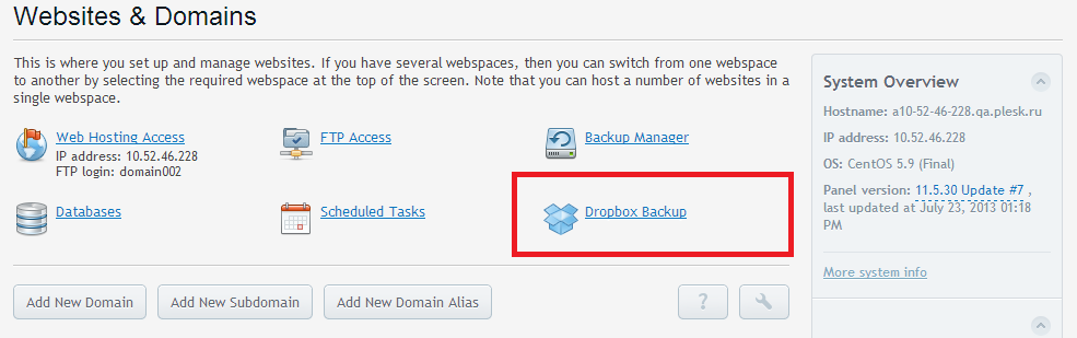

Let’s see the result:
Plesk Dropbox Backup extension

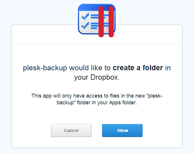

Dropbox uses the OAuth protocol for authorization. The first handling of an API call will redirect you to your Dropbox account in order to get a token for the Dropbox Backup extension:
Plesk Dropbox Backup extension - Access Request

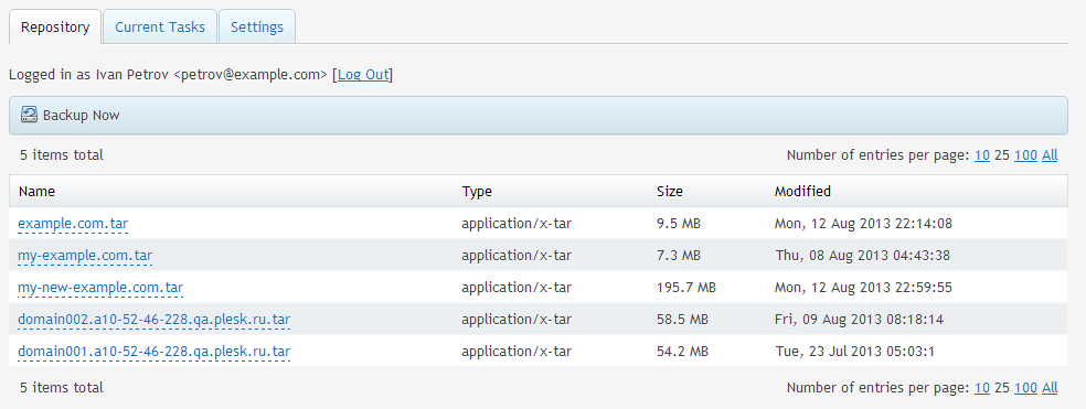

The general screen of the Dropbox Backup extension shows the list of available backups. You can extend the pm_View_List_Simple class to view your own data, paging, sorting controls and other tools in this list.
Plesk Dropbox Backup extension - Interface

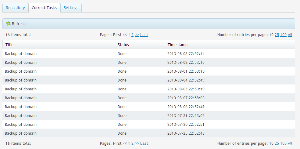

To back up files for the current subscription immediately, click the ‘Back Up Now’ button. All backup and restoration tasks are shown on the ‘Current Tasks’ tab:
Plesk Dropbox Backup extension - Current Tasks

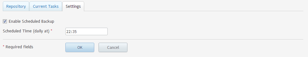

The ‘Settings’ tab allows you to set up scheduled backups. Its implementation extends the pm_Form_Simple class and consists of the basic elements: a checkbox and a text input area.
Plesk Dropbox Backup extension - Settings

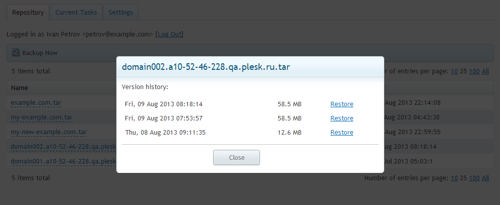

If you are going to restore the subscription (I hope you won’t), click on the backup name and choose the version of the backup file:
Plesk Dropbox Backup extension - Restore
