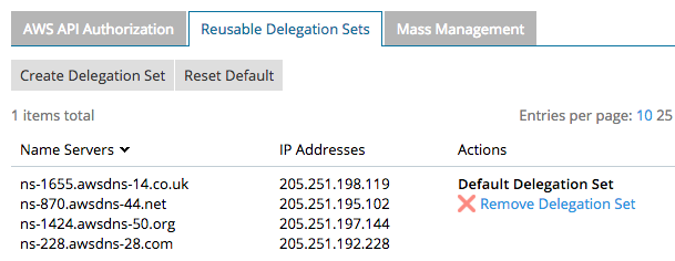

Let us return to Plesk and take a look at the additional functionality provided by the extension. For example, you can create a new delegation set or reuse an existing one from any hosted zone. To do so, open the extension, go to the “Reusable Delegation Sets” tab and click “Create Delegation Set”. This will produce a single row in the delegation sets list. The row will contain a tuple of 4 nameservers and will be marked as default.

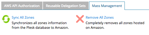

After that, all DNS zones created in Plesk will use the same set of nameservers. It is important to note that due to a restriction placed by Amazon you cannot change the nameservers that are associated with an existing hosted zone, you can only associate a reusable delegation set with a hosted zone when you create the hosted zone. In addition, cleanup in the Amazon Console is rather inconvenient, as a zone can only be removed after all records (except for NS ones) have been removed. Fortunately, the Plesk extension comes with mass management tools (available on the Mass Management tab) that enable you to easily recreate DNS zones of all domains registered in Plesk.
Once the synchronization is complete, you are ready to switch ns1.awesome-hoster.com and ns2.awesome-hoster.com to the IP addresses of the corresponding nameservers (choose any 2) in your reusable delegation set. Open the DNS zone awesome-hoster.com and edit the ns1 and ns2 A records. Take into account that CNAME do not work for nameservers.
