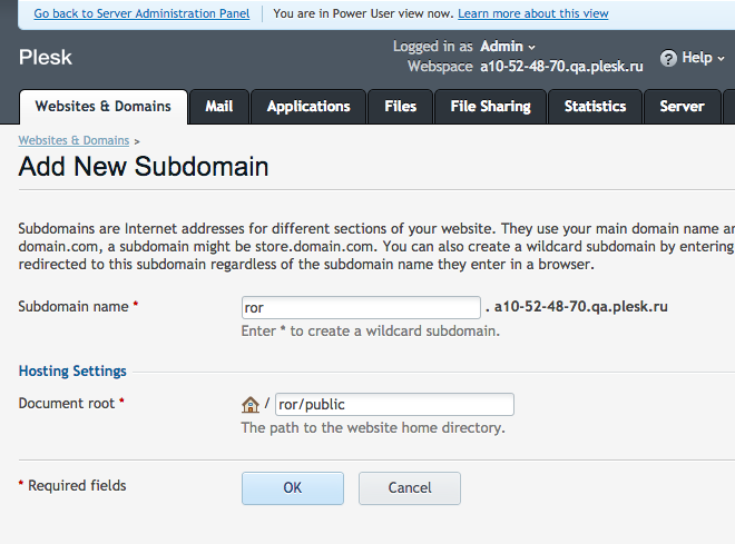

The next step is to create a domain in Plesk for Ruby On Rails application. Let it be subdomain in our case. The document root should point to the “public” directory. Its parent will be the root directory of the application.
Plesk Ruby On Rails Installation - Add New Subdomain
