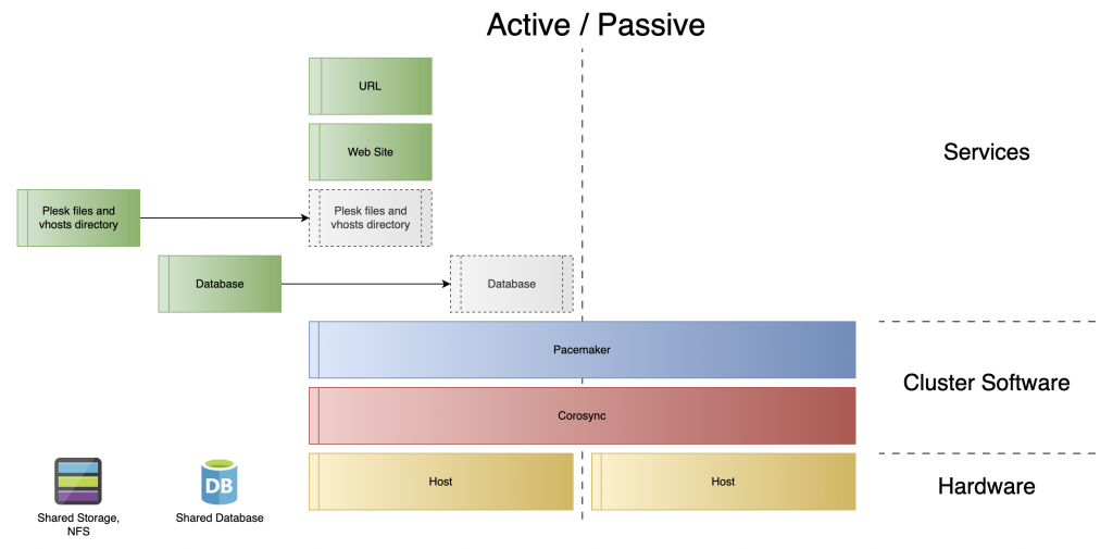

High Availability (HA) Cluster
High availability cluster with Plesk blog
First, let me explain what type of cluster we are discussing. Also called a failover cluster, this cluster consists of two servers where there is only one server that acts as a primary/active server, and a second server that remains in a passive state while the first server is running well. If the primary/active server ever stops working, the second server takes over the role of primary and starts servicing incoming requests.
Please note the failover cluster is not intended to split load between two or more servers, and it is not a high-load (HL) cluster where nodes process requests simultaneously.

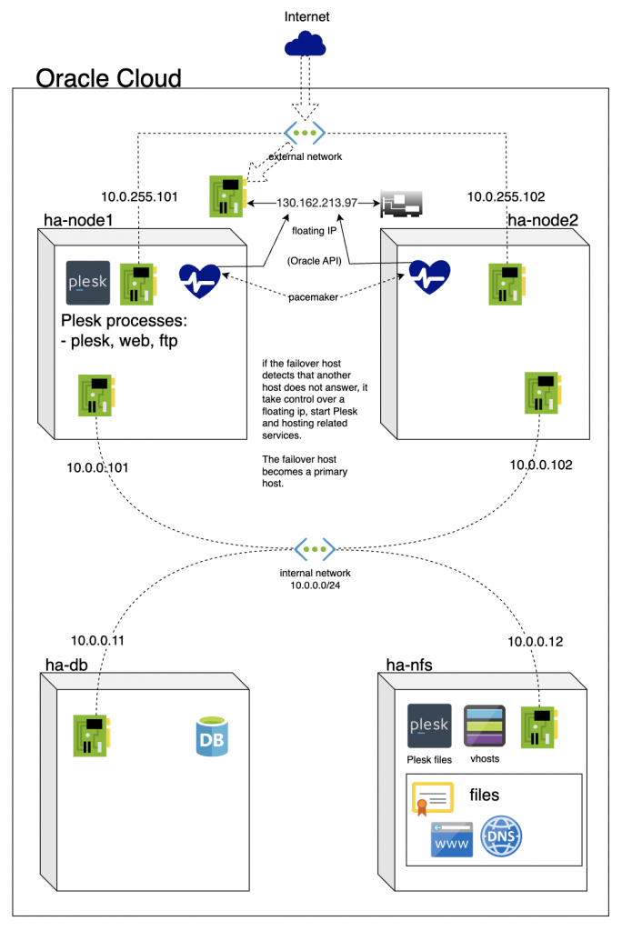

Infrastructure For an HA Cluster
During converting Plesk, to allow it to work on any node of HA cluster, we need to be sure that a server with Plesk does not have any single point of failure (SPOF). So, to ensure that, each node in the cluster should be able to get access to the required files, databases, and any other resources required for providing service like a public IP-address, which is used for accessing the hosting. Here is an example of resources “shared” between nodes:
  • Plesk files
  • Websites’ files (“vhosts”)
  • Databases
  • Public floating IP-address
…but the final list really depends on the infrastructure where the cluster is started. As an example, managing floating IP addresses between servers is different on each infrastructure (public cloud, internal cloud, dedicated servers, virtualization software, etc.) because they provide a different API for that. Which means some of the scripts should be adapted for the infrastructure where you are going to deploy a cluster.
An additional requirement here is that the nodes should be configured as similar as possible. Just an example, Plesk relies on system users and system groups created on a server to manage permissions for subscriptions’ files and starting dedicated php-fpm pools, and it is quite important to have them similar between servers. Otherwise, it could generate issues like, for example, a process on a passive node will not be able to get access to required files that previously were created on an active node because of differently configured owners.
HA Cluster: Preparation Steps

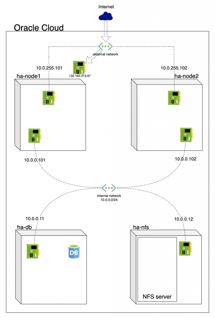

It is time to start deploying a cluster. At this point, it is required to have previously prepared a server with a database service installed, a Network File Storage (NFS) server, and two new servers, which we will use as active/passive nodes. For more information on how to configure and deploy centralized database and NFS for Plesk, I recommend reading our recent blog post here.
Now, I hope your infrastructure is looking similar to the one shown below (which I have redeployed from scratch and going to use for the next steps):

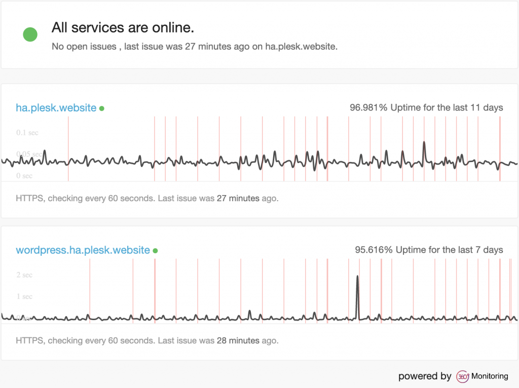

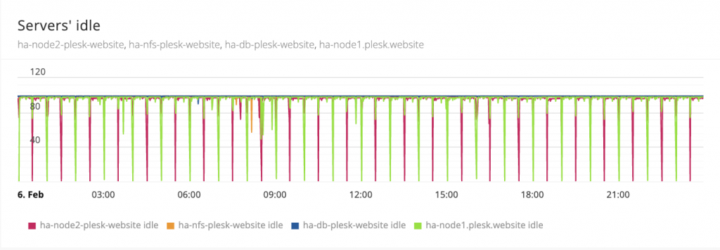

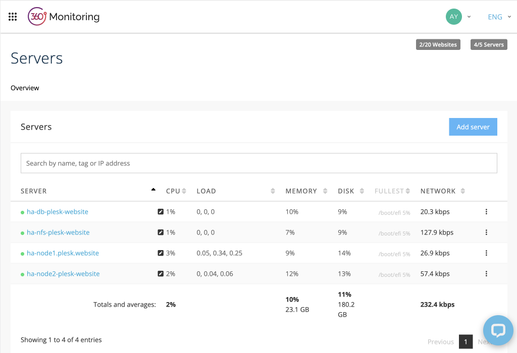

Monitoring
I am also going to monitor the status of each server. For that purpose, I am going to use external 360 Monitoring because only testing from external sources can provide us with reliable data about the availability of servers and websites. Plesk will only work on one node at a time (but we have 4 servers), so I will install agent on each node with command-line interface (the unique token for the command, could be obtained from web-interface)
# wget -q -N monitoring.platform360.io/agent360.sh && bash agent360.sh <unique_token>

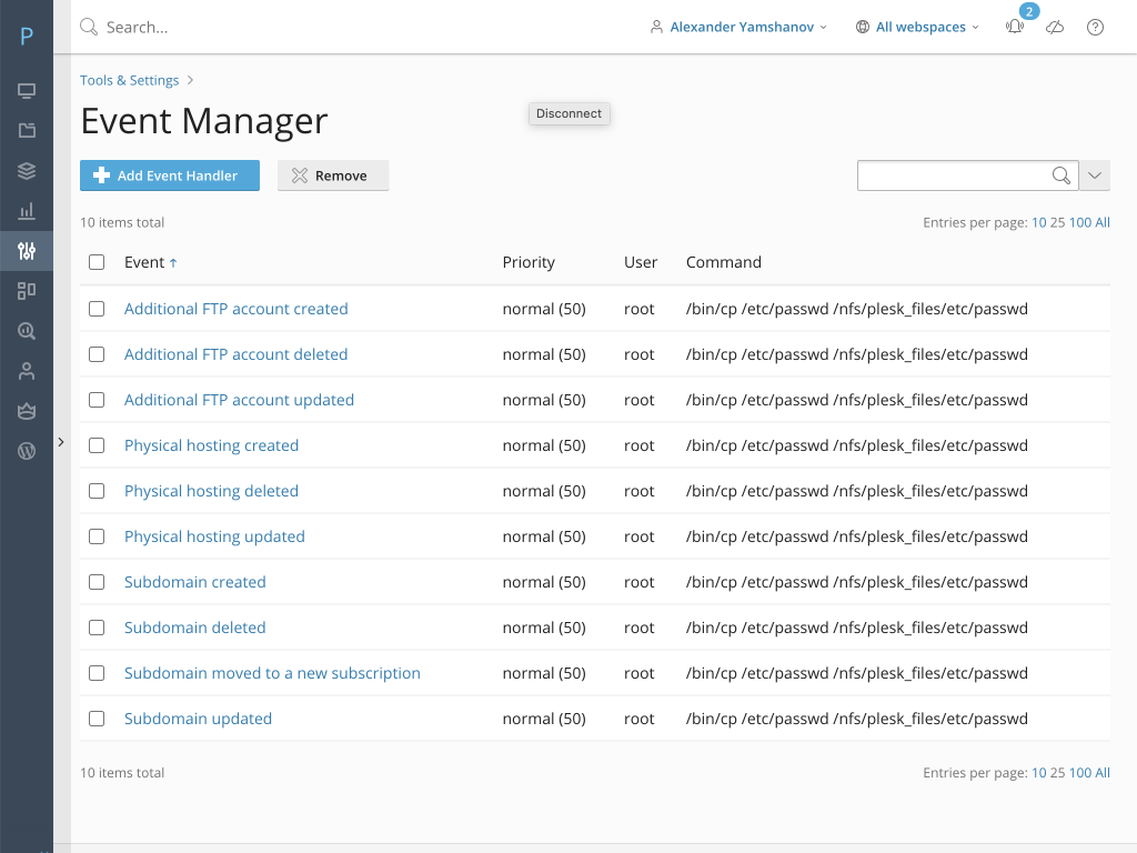

Event Handler to keep /etc/passwd up2date
We need to update the passwd and group file on the NFS storage every time when Plesk updates the system users. For that, we will create a few event handlers for scenarios like domain creating, subscription updating, etc. Event handlers are saved in a Plesk database, which means we need to run the next command only on active node.
As we previously have decided to imagine the ha-node1 as an active node, the next commands should be executed on the ha-node1.
ha-node1# plesk bin event_handler --create -command "/bin/cp /etc/passwd /nfs/plesk_files/etc/passwd" -priority 50 -user root -event phys_hosting_create
ha-node1# plesk bin event_handler --create -command "/bin/cp /etc/passwd /nfs/plesk_files/etc/passwd" -priority 50 -user root -event phys_hosting_update
ha-node1# plesk bin event_handler --create -command "/bin/cp /etc/passwd /nfs/plesk_files/etc/passwd" -priority 50 -user root -event phys_hosting_delete
ha-node1# plesk bin event_handler --create -command "/bin/cp /etc/passwd /nfs/plesk_files/etc/passwd" -priority 50 -user root -event ftpuser_create
ha-node1# plesk bin event_handler --create -command "/bin/cp /etc/passwd /nfs/plesk_files/etc/passwd" -priority 50 -user root -event ftpuser_update
ha-node1# plesk bin event_handler --create -command "/bin/cp /etc/passwd /nfs/plesk_files/etc/passwd" -priority 50 -user root -event ftpuser_delete
ha-node1# plesk bin event_handler --create -command "/bin/cp /etc/passwd /nfs/plesk_files/etc/passwd" -priority 50 -user root -event site_subdomain_create
ha-node1# plesk bin event_handler --create -command "/bin/cp /etc/passwd /nfs/plesk_files/etc/passwd" -priority 50 -user root -event site_subdomain_update
ha-node1# plesk bin event_handler --create -command "/bin/cp /etc/passwd /nfs/plesk_files/etc/passwd" -priority 50 -user root -event site_subdomain_delete
ha-node1# plesk bin event_handler --create -command "/bin/cp /etc/passwd /nfs/plesk_files/etc/passwd" -priority 50 -user root -event site_subdomain_move

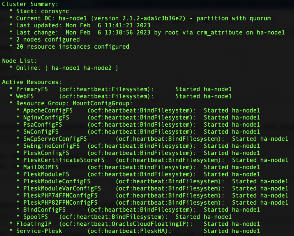

These are almost all the required steps before we start a HA cluster software and configure nodes for using shared resources. To start corosync and pacemaker, run the next command on the both nodes:

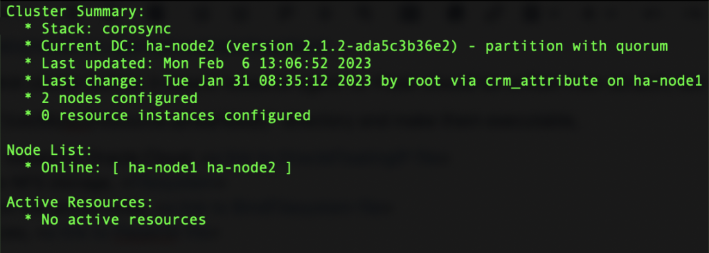

ha-node1 and ha-node2# systemctl enable --now corosync pacemaker
Now you should be able to connect and configure the cluster. To monitor the cluster status, run the `crm_mon` command on any of nodes:
There is no any active resource and we need to configure them now. To enter the configuration mode, execute `crm config`, and the next commands will configure resources and the cluster. There are also additional comments on what each part does:
  • Default settings:
property stonith-enabled=false
property no-quorum-policy=ignore
rsc_defaults resource-stickiness=100
  • Configuring primitive for sharing floating IP address: “FloatingIP” is a name, “OracleCloudFloatingIP” is the name of a resource agent (RA), and “params ip=130.162.213.97” is what we define for the RA. There are increased timeouts because the API requires some time to reconfigure the IP address.
primitive FloatingIP OracleCloudFloatingIP \
params ip=130.162.213.97 \
op start timeout=120s interval=0 \
op stop timeout=120s interval=0 \
meta target-role=Started
  • Configuring primitives for NFS: there are two primitives, the first for Plesk files, and the second for the “vhosts” directory.
primitive PrimaryFS Filesystem \
params device="10.0.0.12:/var/nfs/plesk-ha/plesk_files" directory="/nfs/plesk_files" fstype=nfs options="hard,timeo=600,retrans=
2,_netdev"
primitive WebFS Filesystem \
params device="10.0.0.12:/var/nfs/plesk-ha/vhosts" directory="/var/www/vhosts" fstype=nfs options="hard,timeo=600,retrans=2,_netdev"

Once you have done all the above, you may again check the cluster status with the `crm_mon` command:
The following image shows what we should have now:

If case of disaster on the active node, the HA cluster will automatically restart the resources (incl. Plesk service) on the passive node that make new active nodes. To emulate a disaster, I have created on each node of the HA cluster a task to reboot the server every single hour with a 30 minutes shift between them. For the HA cluster, that means a disaster every 30 min. I also created two subscriptions: one for the ‘Plesk Default Page’, and another one for the default WordPress site.

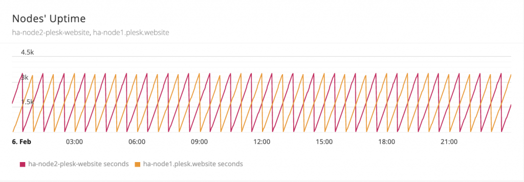

As I mentioned at the beginning of the article, I also installed the “agent360” from 360 Monitoring to each server (including database and NFS) to monitor externally how they work. It’s time to show the graphs for 24 hours.
I configured a cron-task to reboot a server every hour, and because of that we can see uptime 3.6k seconds (1 hour):

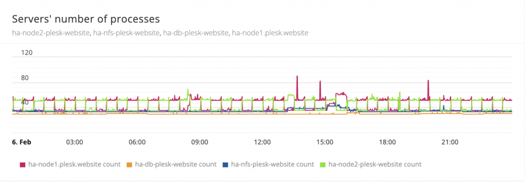

Clustering does not require many resources. On the graphs, the peaks coincidence with the reboots – all resting time we have is ~98-99% of CPU idle:
The graph below shows the number of processes, and how Plesk and hosting-related processes are started on a new node every time there is a disaster:
You may be wondering whether the websites on Plesk have been working all this time or not? And the answer is yes – They work with small downtimes when a role of active server migrates from one node to another. Sometimes the external monitoring was not able to detect the downtime because it performs checkups every 60 secs by default:

For Plesk, it is important to have a similar set of system users on each HA cluster node. This means that if you make some changes on one node, the same changes should be done on the second.
If you are going to use extensions that install additional software, users, or system services, additional steps on the nodes will be required:
  • As an example, if you install a new service on the node (e.g. Grafana), it will not convert into a HA cluster adapted service automatically, you will need to perform additional steps on the nodes for that.
  • Another example is mail. The provided step by step instruction do not configure mail services for working in a HA cluster.
The resource agent Plesk HA does not work correctly with dedicated php-fpm pools because Plesk creates a new ‘systemd’ service on the system for each pool, which means that the services will not be the same on HA nodes and will not be started and stopped correctly.
