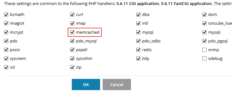

And as they say in France, et voilà! You should now be able to see the extension in Tools & Settings > PHP Settings > *any PHP 5.6 handler*
Php module - Memcached
