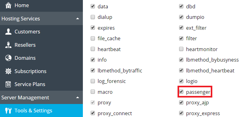

In our case, the application will be a server by Apache. So, you can enable the passenger module at Tools & Settings > Apache Web Server Settings as below.
Plesk + django hosting - screenshot 1 - enable passenger module

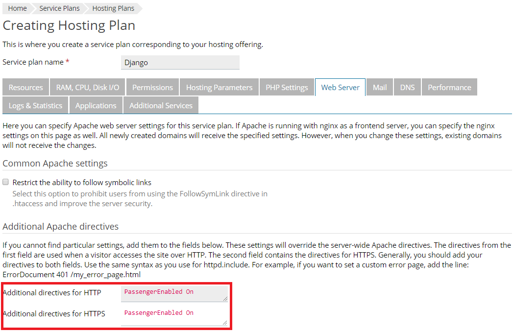

Then, in a Service Plan, which you will be using for domains with Django Apps, enable Proxy mode – if NGINX is installed on the server. And in the “Web Server” tab, add these additional directives, as in the image below:
PassengerEnabled On
PassengerAppType wsgi
PassengerStartupFile passenger_wsgi.py
Plesk + django hosting - screenshot 2 - additional directives for http and https

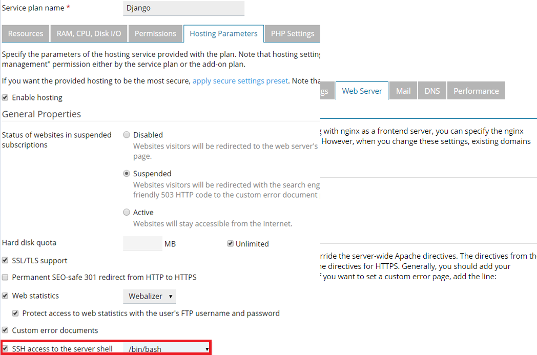

For the next step, set shell options at “Hosting Parameters” tab and don’t forget to save your configuration!
Plesk + django hosting - screenshot 3 - ssh access to the server shell enabked

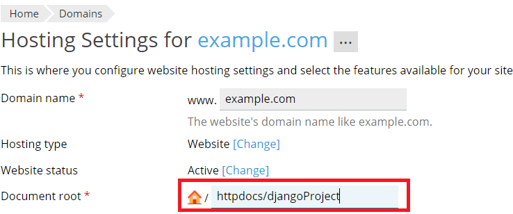

Now all you need to do is to change Domain Document Root, and if everything is OK, you’ll see your application as below.
Plesk + django hosting - screenshot 4 - change domain document root

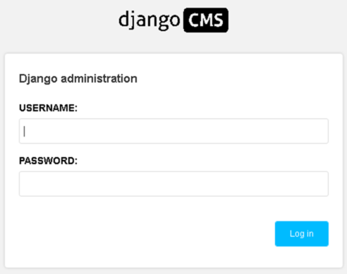

Plesk + django hosting - screenshot 5 - django cms admin login
